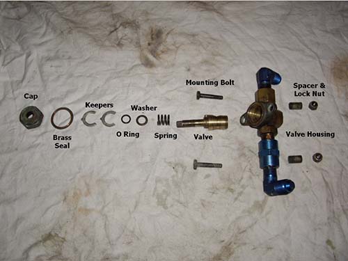

What is wrong with your current one?
The Imperial Eastman valve can be rebuilt mostly- if the shaft leaks you can replace the O ring
And if frozen/ hard to turn it can be taken apart and cleaned up.
They are no longer available, and used / as removed eBay ones can be over $600
