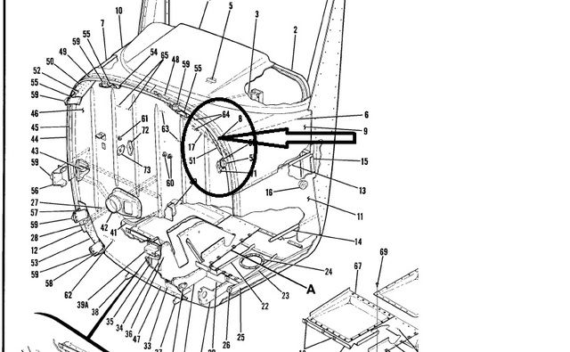

Discovered during my annual yesterday; There is a cracked 3'' section on upper LH of my channel.
Is there any club member you know that are parting out a 150L or 150M or 152 ?
Please let me know. My mechanics say it doesn't need to be the entire Channel (which is about 60'' inches long)
Just the rounded upper LH section (couples inch longer than my crack) so my mechanics can do a repair.
major cessna parts dealer are all wanting 690$ for a piece of extruded channel.
The part no. is 0453107-3
As shown at position 48 in the drawing

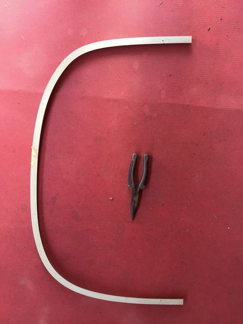

Kendel thanks to you for the lead, and as an update:
I've received the part last week (the long nose is to show how big the angle extrusion is). Got it for 100$
Will get it installed in the next week.
[Linked Image] [s930.photobucket.com]
