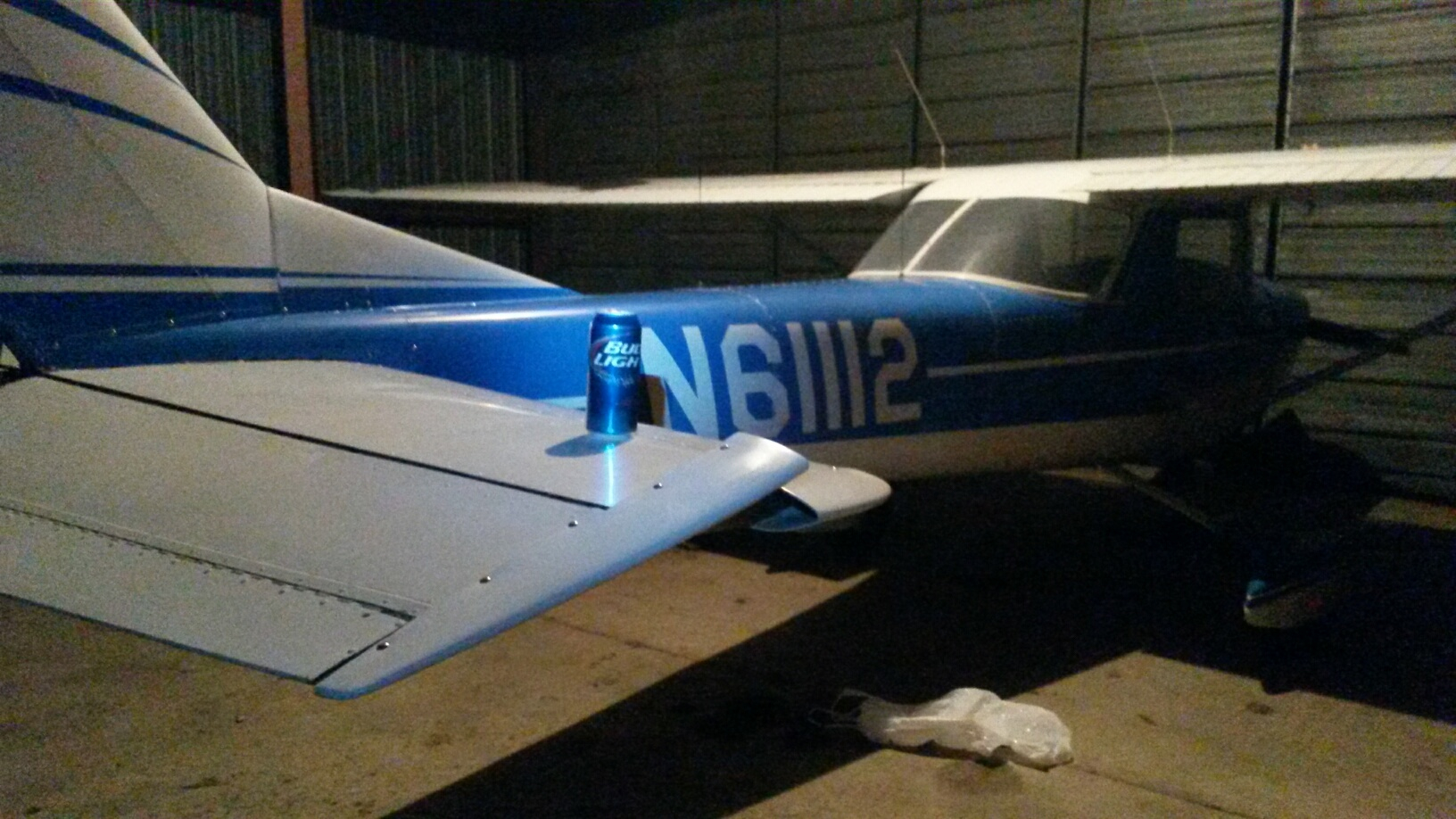

On that note, I'm relived to say, I've finally settled on a name for N61112... Take a look at the pic an have a wild guess!
It took 5 hours and 20 minutes to fly from KRKR to KIFA (about 520 miles) and it cost $78 in 100LL ... and a quart of oil... I flew the entire way with the Carb heat on full... In my estimation the weather was very conducive to Carb icing today, so I didn't want to risk it... I also landed after dark... kinda sporty given the conditions, my first night plane landing in over 15 years!!!
Well, Josh, if that's the yardstick you use to name a plane.....Sierra is being renamed H2O.
Wait a minute. That kinda sounds watered down so maybe Corona is better. smirk
Congrats on the flight home....your journey is only beginning.
