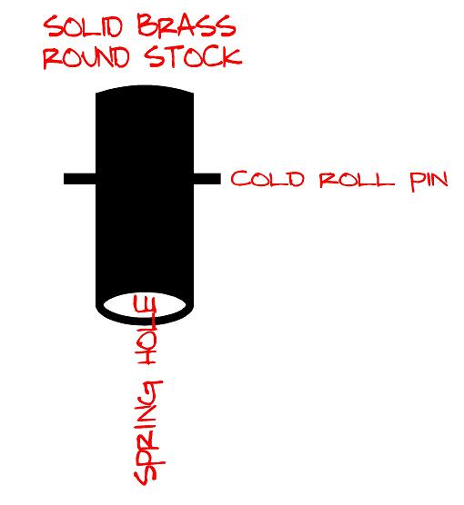

I haven't had the opportunity to compare the VW model to the originals, however, I have a spare Cessna latch awaiting a test I wanted to try. It seems to me, the weak point in the design is the cheesy pot metal spring holder/button that's incorporated into the design. Usually, (let's not use that word) at least in the broken latches I've looked at, it's the button that fails, not the latch itself.
I wanted to fabricate a replacement button using a piece of round stock brass, drilling a hole in the bottom to accept the spring and then, drilling a perpendicular hole through the brass stock to insert a cold rolled pin, in order to keep the buttom secured in the handle and not flying across the cabin. The finishing touch would be to round the head/thumb area off to match the original. It seems as though this would work, but as I said, I haven't tried it yet.
Here's a rudimentary diagram of what I had in mind:

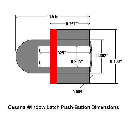

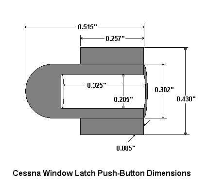

The real trick would be making a button with the two 'ears' that lock the handle in place. When the 'ears' wear down, the handle no longer locks in place.
I measured the button from my window latch. I have too many tongs in the fire to try and figure out how to manufacture this piece. I have found automotive restoration catalogs that sell such window latch buttons for only $5, but none that match ours:

Kirk,
Basically, what I was thinking was, the cold rolled pin (drawn in red) would replace the 2 blades/ears of the original, serve the same function and allow the button to slide in the handles pre-cut grooves. Similar to your modified drawing posted below:
