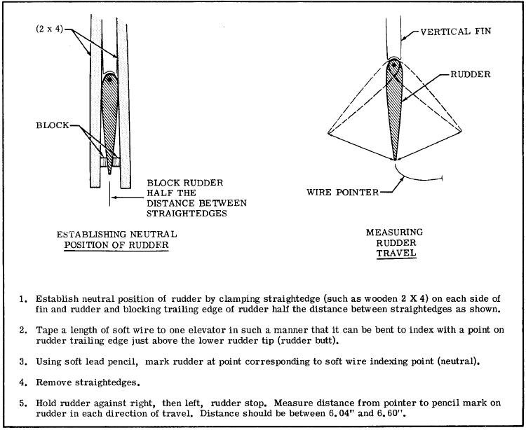

After reading all the threads on this issue I now have to ask how far out should the rudder stop bolts be from the tail? Can the rudder hit the elevator if the stops are not set correctly?
Can a 150 have too much rudder?
I just completed the Placard install and installed the kit on the tail. Before the kit was installed the stops were tight against the tail and had been since it was painted in 1985. We broke the paint installing the kit. No way could it hang up, but now I have suspenders as well as the belt. Value went up two-fold.
Proper rudder travel, both left and right, is specified in the Type Certificate Data Sheet as (for 150F models) 23° measured parallel to chord. For all models after that, it is specified as 23° +0° -2° "measured perpendicularly to hinge line", which is the same as measuring parallel to the chord.
The instructions for this kit call for you to check and adjust the rudder deflection and set the stop bolts, referring to the service manual.
The attached illustration is from the maintenance manual for the 1977 150M, the illustration in the 1969 thru 1976 models is identical. It tells you one method to determine correct rudder travel.
Charles
Visit my Early Cessna150 website
http://150cessna.tripod.com

Thanks Chuck. Now I know and will have to check after we button up the kit.
